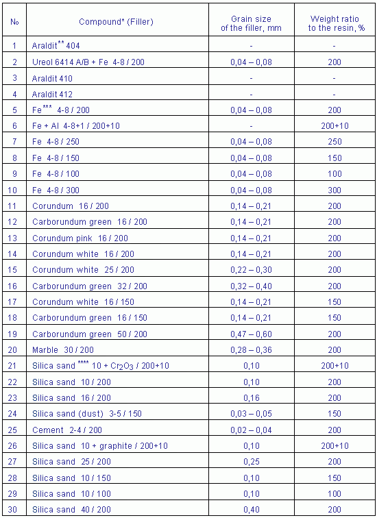

The list of tested compounds is shown in Table 1. They are distributed in three groups. The metal fillers are included in the 1st group (1-10), the mineral fillers with angular or fractured grains - in the 2nd group (11-20), and the mineral fillers with round grains - in the 3rd group (21-30).
Table 1
*In all compounds 5-30, the Bulgarian epoxy resin AP1 is 100 wt.%.  **The compounds Araldit® and Ureol® are production of Ciba-Geigy, Switzerland.
***The Fe-dust is WPL, product of Mannesmann, Germany.  ****Here are used only fractions of silica sand.

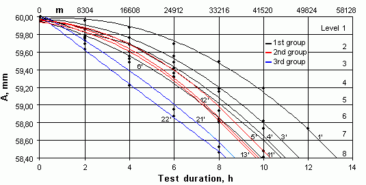

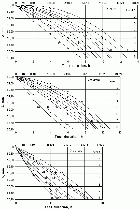

In Fig.29 is presented the decrease of dimension A for all samples from vacuum-sealed sand moulds, and in Fig.30 - for ten chosen samples made in plastic moulds (marked with ' ). The results processing is done with Advanced Grapher 2.11 (2005).
Fig.29. Wear in sand, results for samples made in vacuum-sealed sand moulds
Fig.30. Wear in sand, results for samples made in plastic moulds
In the test time, the dimension A falls in some group of tolerance fields. This group (set) would be more common and then it will have some equal levels with equal limits, or this set would be in according to some standard (or customer requirement) for permissible dimensional deviations of the patterns. In relation to the first possibility, here, the coordinate systems are divided into eight levels through 0.2 mm. The levels are closed between 60.0 and 58.4 mm and they have a fixed value, but in general case, the commitment of the levels with a concrete dimension should not be done. That permits the covering of all real patterns whose dimensions fall in dimensional range, for which the different accuracy classes of standards define permissible deviations up to 1.6 mm (or more with the extrapolation).

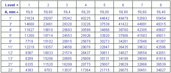

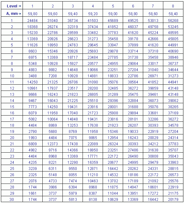

The covered by the samples way L1-8 (in meters) in crossing the limits of the each level is shown in Tables 2 and 3.
Table 2
Table 3
Further in this first point of the proposed approach a representative compound from each group is chosen. This compound is the most wear-resistant. For the 1st group this is compound 1, for the 2nd group - compound 11, for the 3rd group - compound 21.

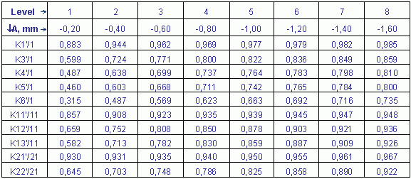

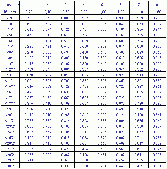

From data in Table 2, the coefficients K1-8 are computed (Table 4). They present a relation between each one of compounds of the group to their representative compound when they cross the levels 1-8. That relation is expressed by division of the meters, covered by the samples. For example, for fifth level Ê57/1 = L57 / L51 = 27785 / 45689 = 0.608.
For the samples from the plastic moulds, coefficients K1-8 are computed too (Table 5), but as a relation to their corresponding representative compound from samples made in vacuum moulds.
Table 4
Table 5
The determination of the coefficients Ê1-8 permits further tests only for the representative compounds of the three groups, which decreases the experimental work considerably, therefore it is possible the application of more hard realizable tests.
