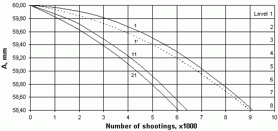

Four samples are tested in the second point (Fig.31). Three of them are the representative compounds 1, 11 and 21. The fourth sample with compound 1' is made in a plastic mould. All samples are manufactured together in equal conditions with the samples used in the rotation and with these which will test in the third point of the study. The samples are fixed to a base and around them a plastic tube is disposed. The sand for shootings is the same as used in the rotation. The shooting (core) machine is KS-3 (Germany) and its working air pressure is 5.5-6.0x105 Pa. The hole in the blow plate is completed with a labyrinth attachment for averting of sand outflow. The lessening of dimension A, mm, after results processing is presented in Fig.32. After 5000 shootings the extrapolation is made (up to -1.6 ìì).
                    Fig.31                                                                                             Fig.32
  The samples before the shooting                                   Wear in sand shooting, results for samples 1, 1', 11 and 21

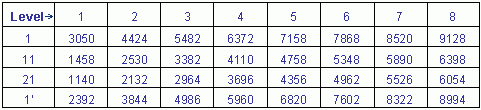

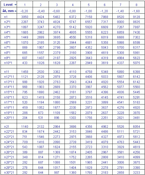

Through interpolation of the results from Fig.32, the number of shootings in which the samples cross the eight levels is determinated (Table 6). By the multiplication of the coefficients K1-8 (Table 4) with the corresponding values of Table 6 is defined the guaranteed limit n of wear-resistance for the non-participated in the shooting compounds (Table 7). For example, for compound 2 and the first level,  n12*1 = Ê12/1 . n11 ,  n12*1 = 0.750 x 3050 = 2287 , with the rounding to integer number.
Table 6
Table 7

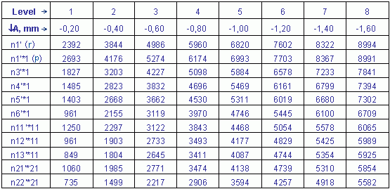

The determination of n for compounds (samples) from the conventional technology is made again by the multiplication of the coefficients K1-8 (Table 5) with the corresponding values of Table 6. The results are shown in Table 8. Except for the computed (prognosticated) wear-resistance of compound 1' : n1' *1(p), in Table 8 is inserted the relevant row from Table 6 for the real wear-resistance of the same compound n1'(r). Thus, it becomes possible to check the approach accuracy by the comparison between these values.
Table 8

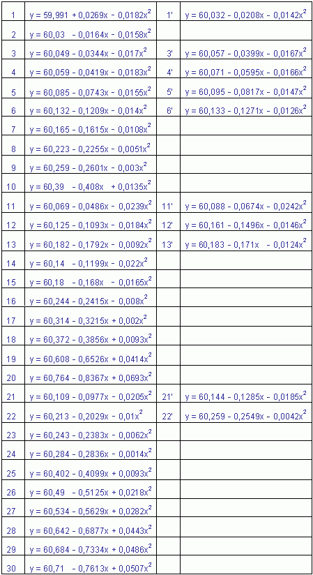

As a result of regression analysis the equations for n are worked out (Table 9).
Table 9
