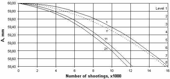

The experiment is carried out with the same equipment, machine (without the labyrinth), conditions and kind of samples - 1, 1', 11 and 21 as in the previous point. The shooting is made with moulding mixture: 6% bentonite, 2% coal dust and 4% moisture. The moisture is checked by standard technique [38] in each 100 shootings. Its permissible deviation is ±0.5%.
Naturally, the moulding mixture components decrease strongly the sand abrasion impact on the pattern materials and it is necessary a great number of shootings in order to follow the passing of dimension A through the eight levels. Because of that, the maximum real made shootings are again 5000 and after that the extrapolation is made. The four curves after results processing are presented in Fig.33.
       Fig.33. Wear in green sand shooting, results for samples 1, 1', 11 and 21

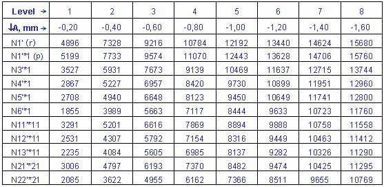

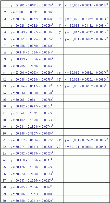

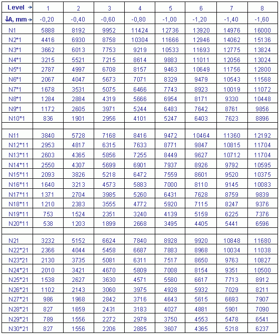

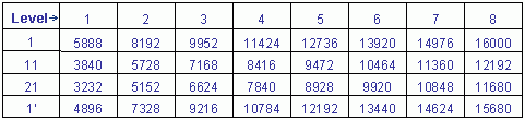

By analogy with the previous point, the number of shootings in which the samples cross the eight levels is determinated (Table 10). Then with the multiplication of the coefficients K1-8 (Tables 4 and 5) with the corresponding values of Table 10 is defined one more limit N of wear-resistance for the non-participated in the shooting compounds (Tables 11 and 12). The regression equations for N are shown in Table 13.
