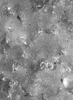

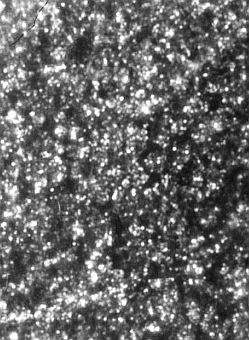

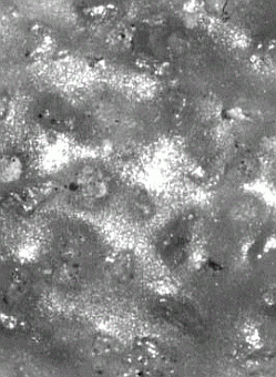

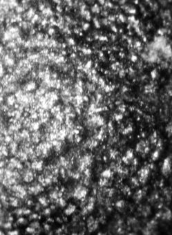

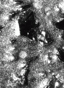

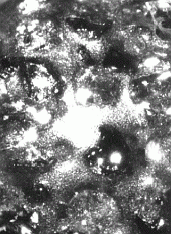

5.5. Visualization of the resin patterns wear
The visual presentation of the resin patterns wear is based on the information from:
- the structural analysis of the external layers of the samples made of epoxy resin AP1 and different kind of filler (Fig.37), and
- the quantitative analysis [41,42] for the component distribution in the working surface (Fig.38).
click to enlarge (x80) click to enlarge (x80)    click to enlarge (x80) click to enlarge (x80)    click to enlarge (x80) click to enlarge (x80)
a)                                                     b)                                                    c)
Fig.37. Some of pictures served for the analysis of the surface structure in the wear (x24)
a) silica sand; b) Fe-dust; c) corundum; left-rounded top, right-wall of the sample.
a)                                           b)                                                         c)
     d)
Fig.38. Distribution of the silica sand (a), Fe-dust (b), corundum (c), and air bubbles (d) in the epoxy resin

Based on the illustrations above and additional microscopic examinations (x40) a brief description of the wear by shooting here is done.
In start position, the most external layer consists of resin, independently of the fillers and the patternmaking technology. That is why, right from the start the sand flow begins actively to cut off the parts of the outmost resin. This process is more slow in working layers structured in the contact of the foil from the vacuum-sealed sand moulds. The obtained shine surface serves as a repulsive screen which does not permit sizable incising of sand grains into the resin. In the samples and patterns made by the conventional technology in plastic moulds, the peaks of their more roughness working layers are broken off and removed easily and fast.
The bubbles on the surface expand quickly and because of their contiguity location to the filler, they undermine its particles. Many sand grains are impacted (wedged) in micropores, and stay there as call forth a microcracks. The presence of similar centers of destruction creates the most favourable circumstances for accelerated wear which is typical for a later period of abrasion for zones without defects.
Gradually, a lots of filler fragments begin a direct opposition to the sand flow. The more quickly fillers take part in the interaction with the abrasive sand medium, the more the surface state stabilize for a long time and the wear becomes weak. That applies to the optimum prepared compounds, in which the filler is good packed with resin. That means that the resin is sufficiency for insurance of the strength of the connection between the filler particles, but not so much for the opening of big areas between them, where the resin fragments are cut off easily and the undermining of the filler grains goes. The sand flow repulsion by the harder grains of corundum (and carborundum) is fairly good. In use of metal fillers begins a process of plastic deformation of their grains. Alter the flattening by the sand flow, the metal grains hold comparatively favourable positions in the structure of the working layer and preserve the contiguous resin from the abrasive media.
Further begins a gradually removal of the resin which connect the filler particles. For a different time it comes to state when the resin between the filler is eliminated, the filler becomes in bracket fixing and it is already possible the breaking out of whole grains or parts of them. The spherical form is more pliable to the entire elimination for the less contact area with the resin. The angular or fractured grain form predestines an inclination for breaking of parts, and more particularly in lapping of contiguous grains. It should be taken account of the brittleness of the hard materials too. The cutting of the deformed thin fragments of the metal filler together with the resin is already good expressed too. The breaking of one or more grains is facilitated strongly by the inside bubbles in every cases. The removed grains open empties and unevenness which accelerates the undermining of the contiguous grains.
Independently of the kind of the filler, in fixed moment a whole its layer is expelled. The wear of the resin follows again, but in contrast to the start, the roughness is higher and the wear grows very fast. That intensity is kept to the opening of new layer of wear-resistant filler.
