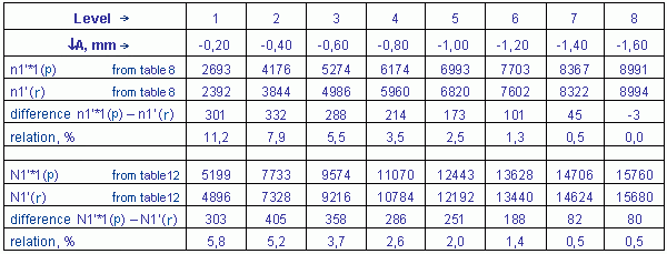

  • A check for the approach accuracy
    For the determination of the approach accuracy the comparison is done between the values for the real achieved wear-resistance limits of compound 1':  n1'(r),  N1'(r),  and its computed (prognosticated)  limits  n1' *1(p),  N1' *1(p). The percentage relations are shown in Table 14. It is visible the prognoses exceed the real wear-resistance. For the guaranteed limit n these differences serve as an information only, because n is passed by all compounds compulsory. On the average three per cent for the minimal limit of wear-resistance N, it is assumes that deviation is acceptable for the practice. So, the approach accuracy is within the range of -3%.
    Table 14

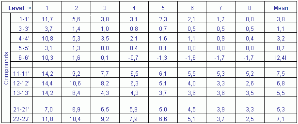

  • A comparison between patterns made in vacuum-sealed sand moulds and plastic moulds
    Using the more wide test findings from the rotation in sand (Tables 2 and 3), in Table 15 are presented the percentage differences between the compared samples. The wear-resistance of the samples by vacuum moulds is better in comparison with the samples made in plastic moulds. The defined average is 4%. That value is near to the approach accuracy, and it is accepted here as non-essential. It is seen as well, in the initial levels the differences are bigger and they decrease gradually to the insignificant 1%. The reasons for that are in the forming of surface layer of the resin pattern in the different moulds and their different surface roughness in the beginning of the wear.
    Table 15

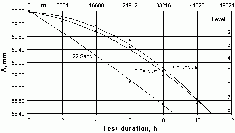

  • The influence of the type, quantity and grain size of the filler over the wear-resistance of the patterns
    The type of the filler influences strong over the wear-resistance (Fig.34). The most wear-resistant compounds compared here contain only one filler in equal relation 2:1 to the epoxy resin AP1. The fixed differences between the Fe-dust, corundum and silica sand grains ensue from the their status in the abrasion wear. The round sand grains become dislodged from the epoxy resin much more easy than the fractured grains of corundum, which are overlapped between themselves and the resin. The silica sand has less hardness than corundum as well. In the wear, the metal fragments hold comparatively favorable positions in the structure of the working layer, and that is the reason for the excellent wear-resistance of this kind of compounds.
           Fig.34. Wear in rotation in sand, results for samples 5, 11 and 21 with different type of filler

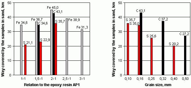

    The influence of the quantity and grain size of the filler over the wear-resistance is shown in Fig.35.
    In Fig.35-a these compounds are presented which contain fillers with equal grain size and different relation to the epoxy resin: for the first group 5, 7, 8, 9 and 10, for the second group 12 and 18, for the third group 22, 28 and 29. The results are referred to the last level (-1.6 mm). The optimum relation of 2:1 is fixed, when more and more fragments of the filler counteract to the abrasion flow, and the quantity of epoxy resin is still enough to ensure strong contact between the grains. Out of the optimum this good balance is broken and wear grows.
    In Fig.35-b the fillers with different grain size and equal relation to the epoxy resin (2:1) are shown: 22, 23, 27 and 30 (silica sand), and 12, 16 and 19 (carborundum). It is determinated that over 0.16 mm grain size, the wear increases. The reason for that is simple - when the more coarse grains become dislodged from the epoxy resin, they form small pits, the resin is removed quickly there and the size in this area decreases faster.
                  a)                                                                               b)
              Fig.35. The influence of the quantity (a) and grain size (b) of the filler
              Fe-ferrum dust; C-carborundum; S-silica sand.

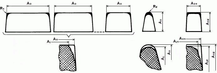

  • Transformation into dimension ranges of standards or according to customer requirements
    The benefit from the described wear research is that the test findings are able to refer to the wear of real resin patterns in their exploitation. When the selection of a determinative dimension (which defines the time of change of the pattern when it will pass under the allowable limit of accuracy) is made (Fig.36), it is easy the transformation of all equations from Tables 9 and 13 into dimension ranges of international / national standards or customer requirements. For example, for
    EN 12890:2000
    [39], n and N can be computed for all patterns in nominal dimension range from 30 mm up to 4000 mm for the classes (quality categories) K1 and K2. It is the same for GOST 11961-87 [40] for its nine classes. But in the last reckoning, how the experimental data for n and N will be used, or the same, what kind of dimension levels will be chosen, the manufacturer of castings will decide.
                                                              a)                                                                         b)                                c)
    Fig.36. A scheme for selection of a determinative dimension (A0, A01 or A02),
    situated horizontally (a), vertically (b) or mixed (c, the smaller size is the determinative)
    Ai-the determinative size in the wear; R1-pattern rounding; R2- rounding in casting construction, R2>>R1.
